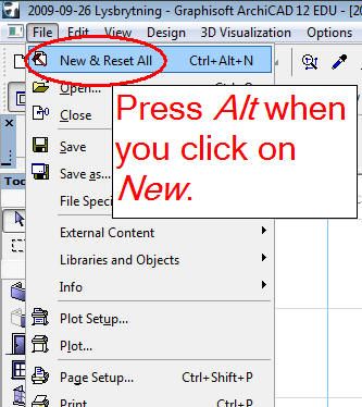

I get this Alternative: Set up Work Environment . I choose Standard Profile 12 .
If you have disabled your Start Box, then take this advice from ArchiCADs Help Function:
To enable the Start ArchiCAD dialog box again, use the File > New & Reset All command.
You will get this choice when you press theAlt Button while you click on New .
