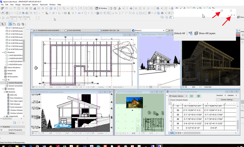

The updates are a little slower than live, but they can be automatic and they are pretty fast. Multiple monitors helps to compensate for the jumping around so much to see what you want.

I cant see how to max. or min. the windows of viewa other than the 3d window. Can you tell me how this is done to achieve a multiple layout like the image in steves post. Thanks
If you are on a Windows machine then see the red arrows in Steve's image.
Press that and you can manually resize the windows.
