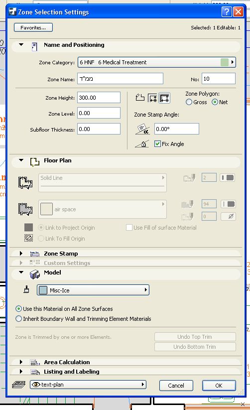

how can i activate this characteristic!? i want the zone's fill to be transperent...the "floor plan" section of the setting window is not active...

Depress the buttons to the left of the Line Type and Fill Type pop up lists.

ok, i did what you suggested. the fill type is now activated but still the fill type on the plan is opec white...

Check the Model View Options > Options for Fills & Zones.

thank you
