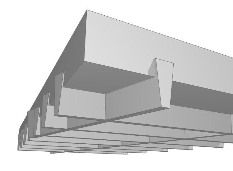

my problem is actually not serious but if there is not solution this should be added to curtain wall. when i add the panel it's reference line exist in the midst of panel thickness, here is the ss link: https://abload.de/img/screenshot_2ekkmk.png we should change the reference lines position as in the slab option. because when we give another thickness to the slab: https://abload.de/img/screenshot_1n7kpb.png we have to arrange the offset of the frame again and again. https://abload.de/img/screenshot_386jlq.png and this is laborious.

Here are the images you linked to.screen_shot_1.jpgscreen_shot_2.jpgscreen_shot_3.jpg

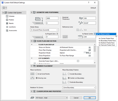

Actually, you can specify the position of the Curtain Wall's Reference Line. See the below image:
