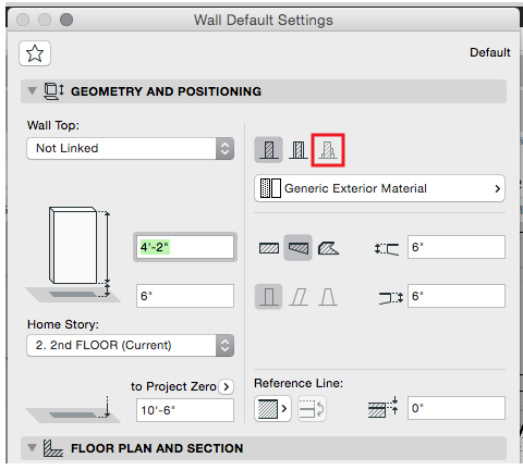

Complex profiles don't seem to work as a wall, but they work fine with columns and beams, ever since I upgraded to archicad 20 student version
I Attached an image of the grayed out complex profile option on wall settings.

One post is enough, please. Complex profiles only work with walls of uniform thickness. You have selected a wall of varying thickness.

Thanks for your help I missed the wall thickness detail, I don't know why that setting changed, all my walls are set to uniform thickness.
