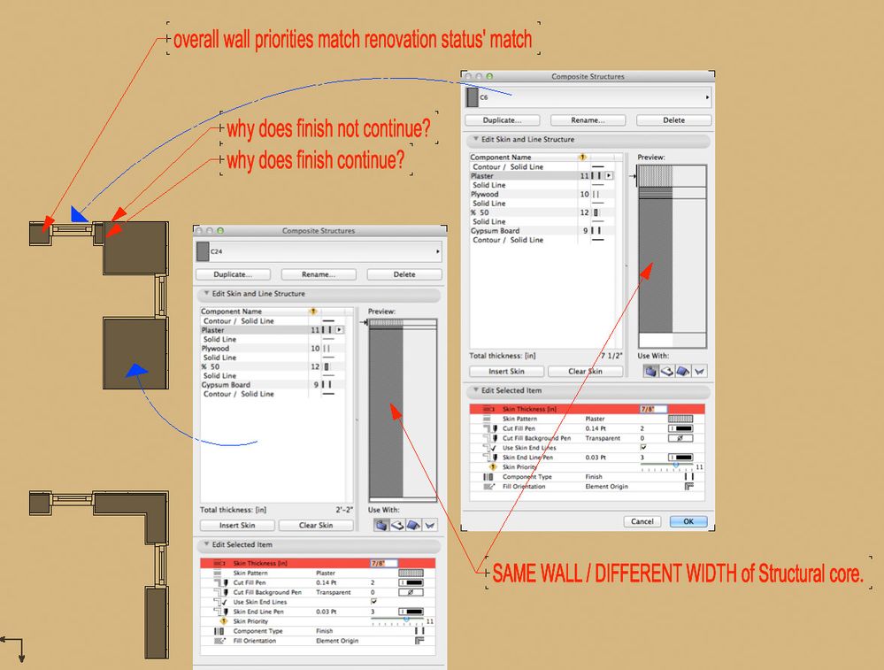

Why can't these clean up?
Every time I go back to composites, I get burned like this... I must be daft and missing something....

What happens if you make the Priority of the Plaster skin less (maybe 9 instead of 11) than the Priority of the Plywood (10)?
I am also curious of what would happen if you moved that Window in the horizontal Wall to the left somewhat? Does that influence anything?
