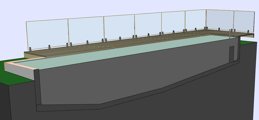

Me too. Just used this technique to model a swimming pool with a sloping bottom. Could have used a Morph too I suppose, but this works well. Thanks Peter!

Hello Duane, Hello Stuart,
Great to hear from both of you.
Thank you.
Stuart, I made a GDL object once of a swimming pool very like yours
but not as flexible as yours because you can change the mesh shape
very quickly.
I must confess the mesh tool is my favorite of all Archicad tools.
One can create precisely controllable plastic forms. When it first came out
in AC 6 I studied it extensively. I am glad you guys know how to use it.
Many AC users do not, I wish they did.
Thank you,
Peter Devlin
