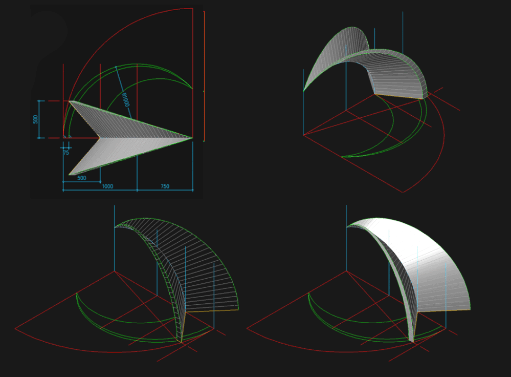

I hate to say it again, but this is very easy with Autocad!
It took me 29 minutes to model it, 20 of them to test and define the form in 2D! And this is not approximation, it is the real thing! Autocad R14, date of issue 1998 or earlier!
