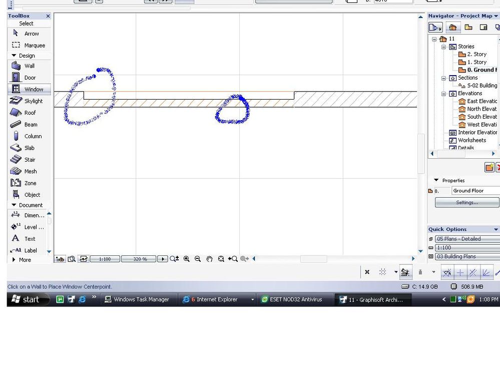

i created this custom wallniche as described in the AC11 help
but it is not showing properly in the plan view
how to show brick fill pattern in niche?
i have changed the colour to black in the 2d symbol window but still it is appearing blue.
Also that plaster layer is not extending over the niche

i created this custom wallniche as described in the AC11 help but it is not showing properly in the plan view
plz help.
Since this is a rectangular niche, why don't you use the W Niche 11 part? It has the proper 2D Symbol. Otherwise you need to write a 2D Script for the part (this one you posted has only a 2D Symbol) to pick up the fill of the wall.

i am able to add fill by applying the fill in 2d symbol window
Sometimes the fill pattern does not match the wall fill pattern.
and i get a line on both side of niche.I have changed its colour to white(255) but it is still visible. how to remove that line?

Again, why don't you use the W Niche 11 part? It has a working 2D Symbol that fixes the problems in your part.
