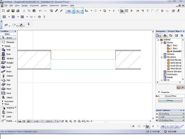

creating wallniche
i created this custom wallniche as described in the AC11 help
but it is not showing properly in the plan view
how to show brick fill pattern in niche?
i have changed the colour to black in the 2d symbol window but still it is appearing blue.
Also that plaster layer is not extending over the niche

here is the file i used to create that niche
please somebody help
i am going crazy

ishpalsingh wrote:
i created this custom wallniche as described in the AC11 help but it is not showing properly in the plan view
plz help.
Since this is a rectangular niche, why don't you use the W Niche 11 part? It has the proper 2D Symbol. Otherwise you need to write a 2D Script for the part (this one you posted has only a 2D Symbol) to pick up the fill of the wall.

thanks for replying
i am able to add fill by applying the fill in 2d symbol window
Sometimes the fill pattern does not match the wall fill pattern.
and i get a line on both side of niche.I have changed its colour to white(255) but it is still visible. how to remove that line?

ishpalsingh:
Again, why don't you use the W Niche 11 part? It has a working 2D Symbol that fixes the problems in your part.
