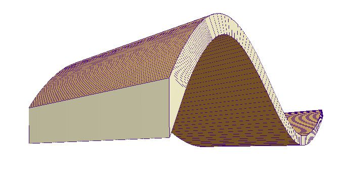

Is anyone able to teach me how to make curve ceiling? I try to use magi wand to make curve ceiling, but it doesn't work. I don't know where do i make the mistakes. :oops: please help me out. Thank you :lol:

I use spine tool to draw curve--> then use ceiling tool and magic wond to make it happen
Vaulted roof, right?

not vaulted roof. It's more like S shape roof. here is the sample what I was tring to do before
now, I am working on the ceiling is curve X direction and Y direction. I am thinking maybe the mash tool is the only tool to make this work. BUT haven't figure out the way to make it work :?
ArchiForma.

sorry! What's ArchiForma mean? :?
Ben Odonnell
ArchiForma is a really nice application(Add-on) to ArchiCAD. You can find out more about it here. http://www.cigraph-store.com
