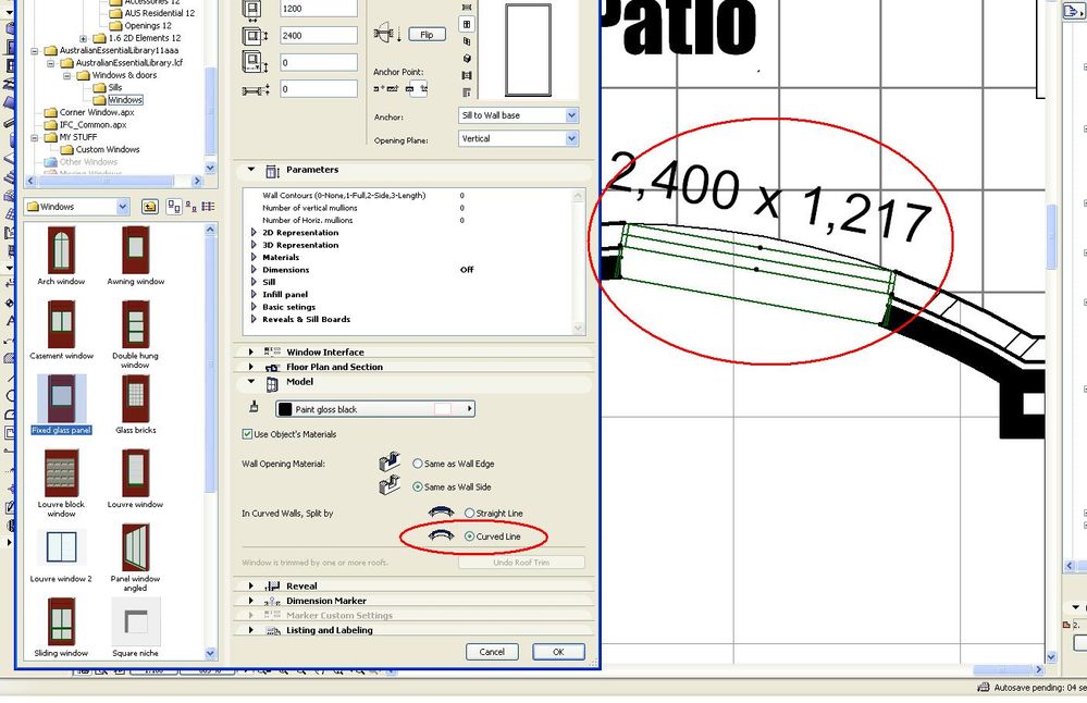

i wanna stick some windows in this wall and make them curved.. i pushed the litle "curved with wall" button but dosnt make any change with the item? am i meant to be doing something else?

and this, already in the ARchiLie-berry " W M Curved 12"
Dwight Atkinson
the curved with wall thing applies only to the cill, not the glass, i'm afraid.
depending on what you're doing/ need, either use a curved window from the posts mentioned above or, as it would be in real life the window would be a series of straight facets so you 'd model it that way.... HTH

opps my bad.. should have looked a little better before asking.. cheers guys
