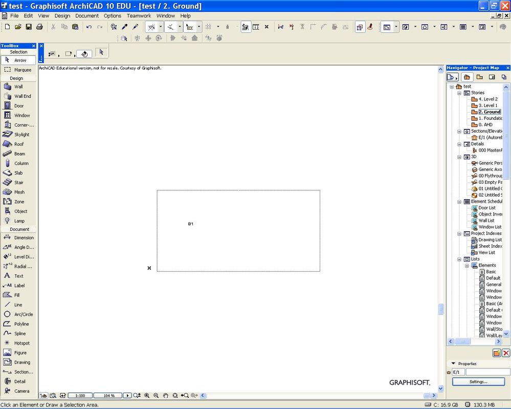

im rather new to archicad 10 i am using windows xp as OS
for some reason in my plan my lines dissapear, i know the objects are still there because when i highlight them they are visible.
and they are also there in 3d view
i at first thought it was my floor plan cut plane but as is in the attatched jpeg i believe this is not the reason
thank you for your help.

They are visible once i select them i dont understand please help..
i just noticed something else,
when i draw a wall and take the section the wall has dissapeared in the section also
the levels are switched on, i believe the levels are correct.
the wall selected in section
anybody have any idea??

You probably have the wall settings beyond the range of the storey settings.
If the wall is set to automatic it will be invisible if outside the range of the storey. Section lines can also do this.
Cheers John

is it possible that my archicad 9 edu could be the reason, what if i uninstall it?
and it was not set to automatic and it was within the range?
actually i think you are right because when i place the wall it shows up
when i place the roof and then elevate it is then when it dissapears how do i fix it?

change the wall settingso it says not "automatic" - Unfortunately i cant remember the exact menu names
