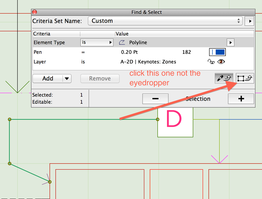

I am trying to use the eyedropper feature in the find and select menu. When I click the eyedropper button and select a line who's "similars" I would like to select with the finder it does not pick up those lines parameters. Am I doing something wrong, or am I assuming the eyedropper does something that it was not designed to do?

If I understand you to select same objects using Find and Select you don't use the eyedropper you use the Copy Settings option in the palette.

Click on the eyedropper button in the "Find and Select" dialog box, then hit alt+c on your keyboard (windows). Now you can click on any element, and the settings of that element will be injected into the "Find and Select" area.
Best,
Foster
Gus
Awesome!
Got it.
Thanks for the help.
Huge time saver.
