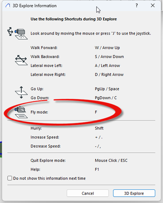

I’ve been experiencing some issues with the EXPLORE MODE, which I initially thought was related to a button. I downloaded the new update today (28.2.0), but the issue persists. Therefore, there must be a setting somewhere, but I can’t figure out where it is. When I select the EXPLORE MODE from the menu or toolbar, the model seems to automatically step down and doesn’t stop. I have to press the ESC key to exit the mode and switch to ORBIT mode.

Fly mode perhaps?
When it is off, you will be stuck in a horizontal plane (you can still page up/down).
When it is on, you will go up or down to where ever you mouse is looking.
There is no gravity to a surface that I know of, that is in BIMx.

I wanted to follow up on your suggestion regarding the issue I’ve been experiencing with AC28. I believe your suggestion was the cause of the problem, and I’ve been trying to find a solution, but I haven’t been able to. When I first open AC28, I remember turning off the “DO NOT SHOW THIS INFORMATION NEXT TIME” option. However, I’ve noticed that this information window doesn’t have any settings available. While I’m in Fly Mode, I’m stuck and can only use the ESC key or the “J” key to switch to Joystick mode. The problem is like the DOWN arrow is locked, and It only move down without any input. Pressing any key doesn’t work either. If I can identify the root cause of the issue, I’ll be sure to report it. Thank you for your concern. Have a nice weekend, and a happy Father’s Day to all fathers.

I am not sure what is happening to you (but be sure not to discuss the Beta software outside of the Beta forum).
The down arrow will actually be moving you backwards.
'Page Down' or 'C' will move down.
So are you saying that as soon as you go into explore mode, your view just drops down below the model and you can't stop it except to ESC (cancel)?
The joystick mode is very sensitive.
If you are holding the mouse over it with the left button pressed, the slightest of movements off centre will keep you moving in that direction.
Personally, I would forget the joystick.
