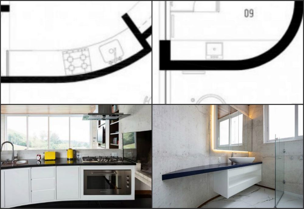

Hi!
Can anyone tell me how can I adjust this elements to these curved walls? I also have problem with shower cabin because is curved on one side, but when I try to change it's dimensions, the program doesn't allow me, because dimensions are standardized I guess. So does anyone know how can I solve this?
Thanks!
I would use a Slab for the countertop, which can have curved edges, then place individual Objects for each of the cabinets, rotating them to match the chord of the countertop's curve at each cabinet location. This is similar to how I would expect it to be built.
