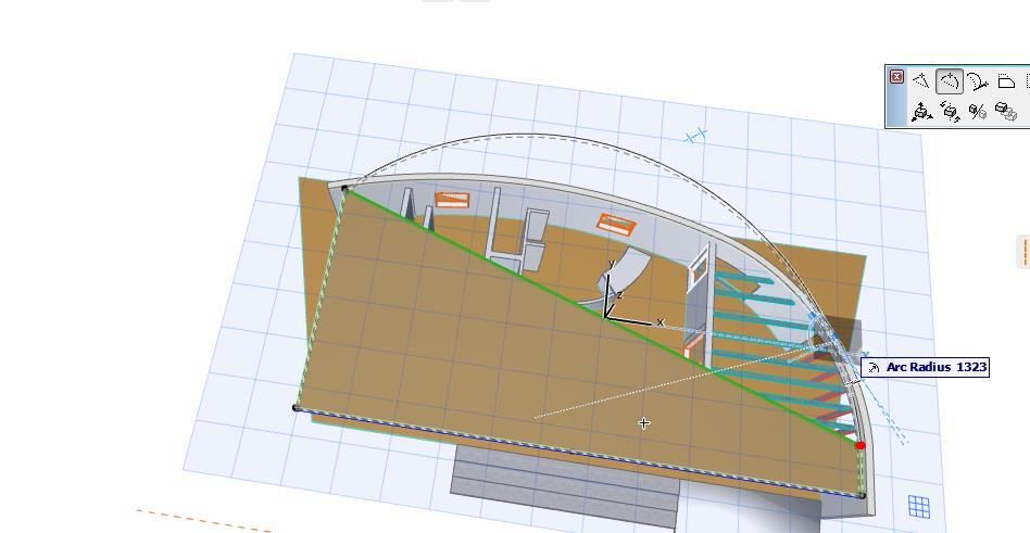

You meant something like this? Well, it's the closest to the solution so far, but still not getting the right curve... I tried positioning red spot many times, but I didn't change the situation.
You need to match the nodes of the slab/roof with the nodes of the wall where the arc begins, then curve to match.
I did that, still doesn't work Is there any way I can post file here so someone can do this? I need it for my college task, but I'm struggling too long with the roof, and I don't have more ideas or strength for trying. I would be very thankful if someone could take a little time to help me.

march:
From your screen shot, it looks like the Wall is made of multiple segments, each segment has a different arc (radius and length). You will need to add a node to the Roof at the start/end of each Wall segment, then use the Curve Edge option in the Pet Palette to create the arcs you need to fit to the Walls.

Yes, I did that and probably that's was a problem, but I made it this morning by myself, doing something similar, so I finally solved this. Thanks everyone for helping!
