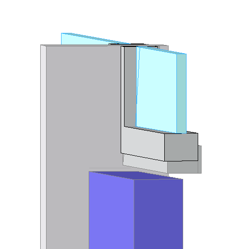

i have this problem:
there is a space, a gap between the panel and the window in the curtain wall and i dont konw how to fix it...
any help appreciated.

It looks like you set the horizontal frame that would go there to invisible.

Thanks Erika!
