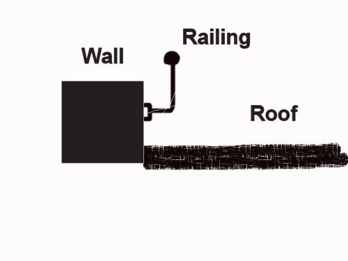

get right railing
5 REPLIES 5
Djordje
Model the railing elemens using Profiler.
Assemble them in place.

My 2 cents worth: I have found Trussmaker on the Extras menu to be an easy way to create complex linear handrailings and balustrades, due to the ease of editing individual elements.
Generating details from this element is also a relatively simple exercise as the library part is separate from the stair structure part.

damn.. i cant create that st**** rails
Now i need this kind of rail.. but its impossible!!!!!!!!!!!!!

Complex wall or beam profiles are another great option for constantly extruded items (AC 10 only). This also adds the benefit of easy editing if something in the project changes, unlike the profile tool where you need to re-create the entire object.
