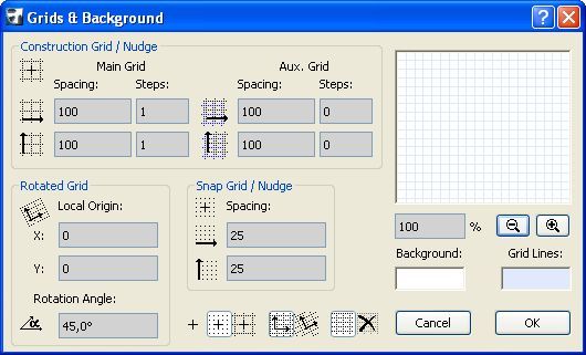

The same bug has shown up here.
Construction grid 100 mm. Snap grid 25 mm
(No rotated grid and/or user origin)
(Fig1)
