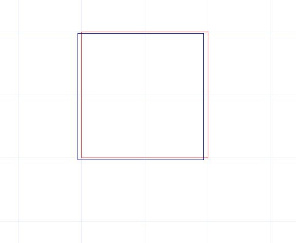

Snap and construction grid doesn’t align.
The small black dot next to the cursor shows the snap grid, which should align to the origin (in the middle of the circle which I have zoom in to.)
Origin x,y = 0,0
Black dot x,y = -7,-3 (mm)
(fig2)
Test.
Turn on Construction grid. Draw polygon in red.
Turn on Snap grid. Draw polygon I blue.
The polygons should overlap, - they don’t
No user origin.
If edit origin was in effect it should now be relative to the red polygon. (Relativ coordinates turn off)
Conclusion: this is a bug. Please fix fast.
