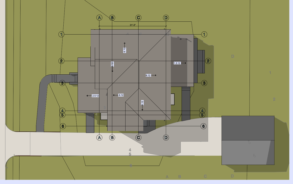

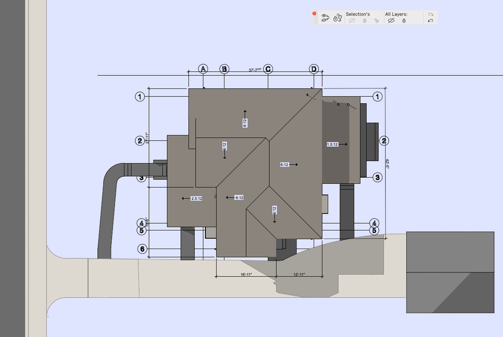

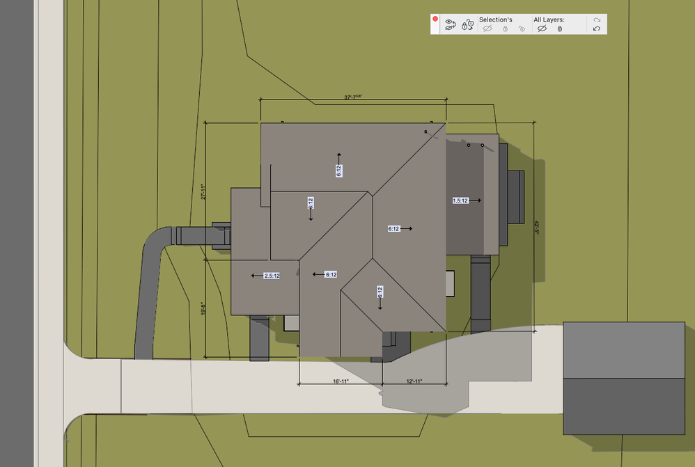

I have created a top view 3d document for use as a Roof Plan.  But I am unable to get the Grid Lines to show on top of the drawing.  I have to turn off the mesh to see them or select them, and even then I cannot "bring to front" in the display order.

Hi @Dave Brach,
You can see your grid above the mesh if you elevate the grid level to the top surface of the mesh from this dialogue via (to project zero).

Mahmoud, thank you, that works!  Of course now I am seeing why it would be nice to be able to adjust the linetype;  also, the Grid numbers/letters are casting shadows
