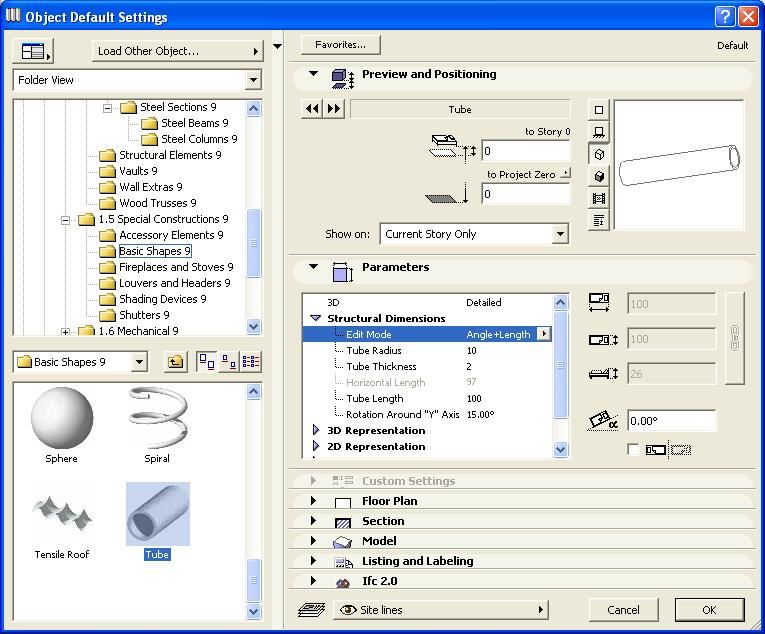

I am constructing a steel roof in Archicad 9 and rather stumped as to how I create raking CHS (circular hollow sections) set at an angle of 30 degrees and going from a ridge steel down to a horizontal UB tie beam.

Could you draw a simple sketch what you exactly will do?
Hi Turboglider, drawing a sketch in 2D is what I will probably end up doing, but the whole point of ArchCad is that it is supposed to be a 3D programme.
The sketch is so we know what you are asking. Look at using a custom profile and the beam tool. The profile will represent the cross section of the steel you are using. This is only in 10, so if you are using a previous version of Archicad, you will have to explore other options.

Check the steel elements in the library, their parameters for sloping and cut planes at the ends.

You can always use the primitives from the standard library - for example, Tube from Basic Shapes?
