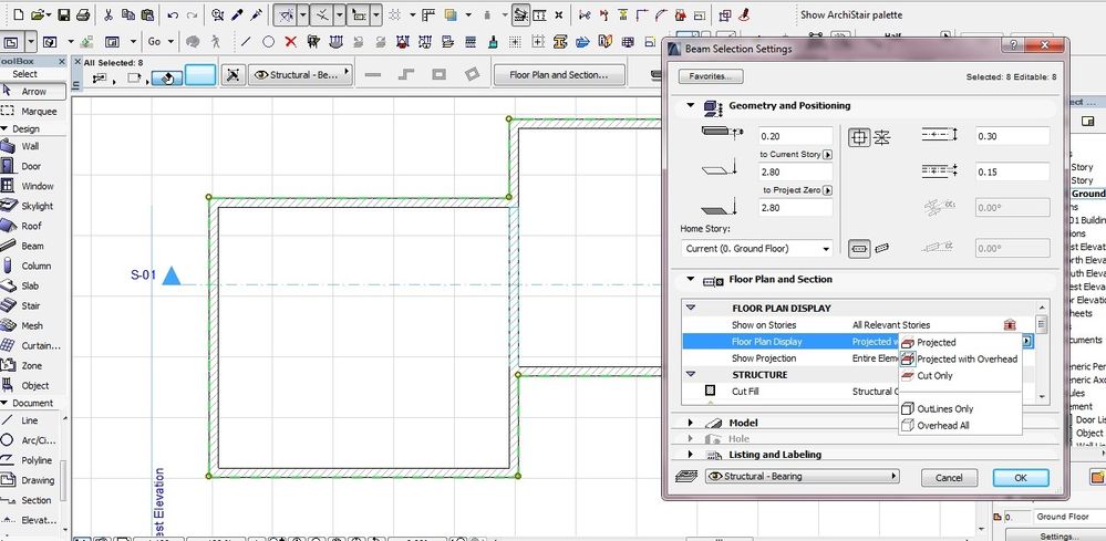

how i can hide beams projection in floor plan display ?
Hi i have question i tried to hide projection of beam over a wall by trying to do changes in setting ,beam priority but i still can not hide the lines of beam what can i do to hide the beams projection over floor plan display and thanks

Select the beam and use the command Display Order > Send to Back, or select the wall and use the command Display Order > Bring to Front. If you are not familiar with these commands, search them in the Help files.
