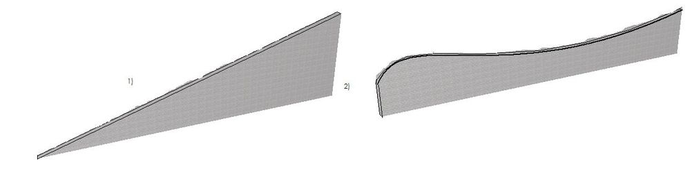

how to create walls
i'm new in archicad, and i want to know how to create walls like in the picture

Draw your walls and then with the roof tool create a roof that will be used to trim the wall to the desired shapes.
If you use the trim-to-roof techinique you can delete the roofs.
If you use the solid elements operation technique put your roofs on a layer that can be turned off (SEO layer).

hmm.. so then how can i create roof so wavy?
The roof tool has a geometry method for making curved roofs (segments along a curve really). It is s little tricky at first but pretty easy once you get the hang of it.
Dwight
The answer to your question is on page 146 (or so) of the Reference Guide "Drawing Barrel Vault Roofs"
