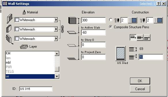

i think you know there is Special drop down menu in archicad. this is useful, but you have to swich it on every time you start the program. it was described somewhere to change win registry item to have it swiched on always when you start ac (with 5.0 you have to hold down Alt key duering program startup until menu items appear and have Special menu switched on)
i tried to tell that changing menu behavior on object properties was not good - attached 5.0 dialog box (if someone is not familiar with this version) and compare this to newer version -
it is all there at once on 5.0 (or 5.1)- change and select what you want
same with object properties dialog box - all what there is to change is in one dialog box, not divided to three different panes you have to 'click' separately in newer versions (look at your version properties box)
changing that menu behavior and have divided menu appearance in 6.0 and later was not good keeping productivity in mind - you will be surprised how much time you spend on (additional) mouse clicking!
that is what i miss and was writing about, Karl!
I see. But, you do realize that the Info box in 8.1 can be customized to contain what you want .... then you do not even have to open the settings dialog? Yes, the dialogs in 8.1 are longer (as were those in 6.5 and 7.0 - which used tabs), but contain much more information to customize every element. The price paid for power ... but again, someone who does not want to see all of that can work from the info box.
