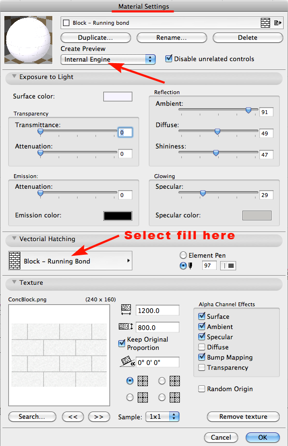

What's the best way to create a 2d fill pattern to show on walls, etc. in the
section elevation?
Looked in the surfaces dialog and my textures for the walls are already assigned jpg's.
for my ledger stone veneer and stucco walls and they look great in open gl. However, am having trouble figuring out how to assign a fill pattern to them so they will also show a 2d line representation in the section / elevation views.
Took a look through the fill patterns and did not find one that will work
for the ledger stone, so will need to create my own. I have the ledger stone drawn on another job that I did about a year ago, but before I start
trying to figure how to do it I thought I would pose the question here first.
Regards, Jon
P.S. In the wall settings dialog I can't find anywhere to assign
a fill pattern to the surface other than the surfaces which already have a jpg. specified.

You can create a fill pattern by drawing with lines at an appropriate scale, copy the lines, then paste into a new symbol fill. You assign this fill to a material in the Vectorial Hatching section of the material's settings when in the Internal Engine options. (You do not assign the fill to the wall itself).

Select the fill pattern in Material Settings dialogue, as shown below.
A tip when you create your fill pattern. Make sure your pattern is seemless when it repeats by having some of the stones continuing thru' across the edge. You might also have too many lines too close together for a good result.

It doesn't show up in the surfaces dialog / vectorial hatching button??
I got it!!!
Had to select the cover fill radio button in fill types.
Thank you very much!!!!
Now I can send the elevations to the client. Yahoo!!!!!
Check the Cover Fills box in your Fill Type settings
