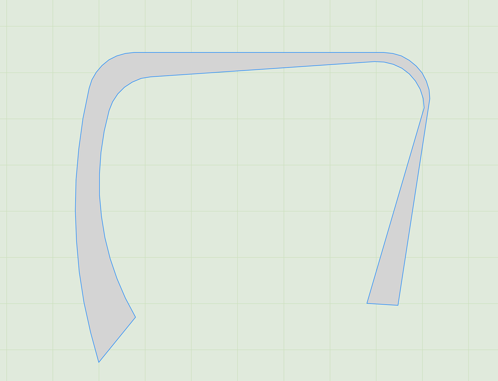

Hi.
How can I create a wall with this shape (see image below) that has a wall height that evenly increases from start until end?
I have managed to do a simple case by simply creating a wall from polylines and convert it into a morph thereafter stretching the top end wall line downwards. This doesn't work though when the wall has a more complex polylines (more aggressive curves) e.g it has a lot of nodes hence it doesn't work to lower the whole wall after morphing it.
14 REPLIES 14
Create a curved wall with the wall tool,
Morph the wall,
Split it in two equal pieces,
Use the pet palette to offset edges up or down to suit.
That's what I have tried but I can only create the desired shape by magic wand. The thickness of the wall is also inhomogenous and one end of the wall is not a straight line, it is pointy. Hence I cannot even pull down that line with offset.
