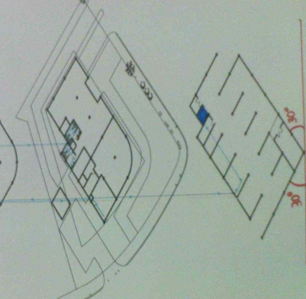

can archicad make all the plan become isometric?
I want to make utility diagram but I can't make my plan become isometric...
please help....
thank you very much.....[/img]

thank you for the help, but I want to make 2D isometric plan, not in 3D.. I have to make a 2D diagram plan for Utility System..
so it's just like one line drawing..
sorry, the picture should be facing down

That's still a 3d model, Erika. I believe Christaline just wants to view the 2d linework as an axon.
I think there maybe a way to do it, but I haven't tried it myself!
Save each of the 2d floor plans as objects as described by this wiki article here. Open a new empty ArchiCAD file and place each floor 'object' onto a separate storey. Use trace and reference to align them over the top of each other. Set the 3d window to Axonometric mode and view the plans from the required direction. Adjust the storey heights so the plans do not visually overlap. Now save this as a 3d document and annotate.

To show the linework from a floorplan in 3D (and thus isometric), you can save the floorplan as DXF and make it an object.
