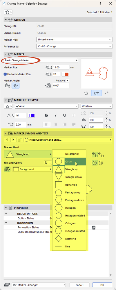

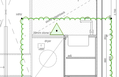

Hi there,
How would i change the marker head from a triangle to a circle in archicad 29?
There seems to be an option to change the marker head in older archicad versions but not here.
1 Solution
I don't use change markers.
But it looks like you can't be using the 'built-in' marker.
Change it to the 'basic' one instead.
Go to post
5 Replies 5

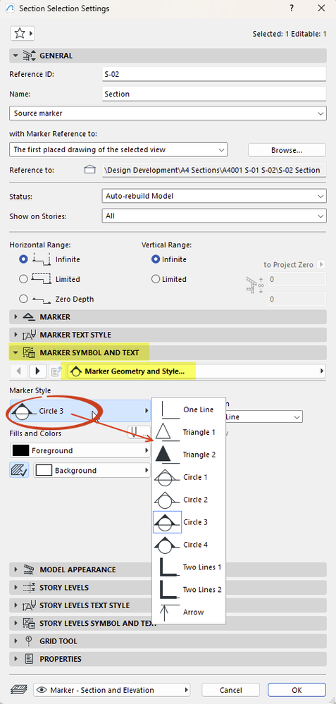

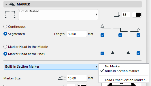

If you mean section and elevation markers, it should all be the same as before.
In the section/elevation settings.
Lingwisyer
Guru
If you do not have the options Barry is showing, check which marker you are actually using.
Ling.
clauds1223
Sorry, no I mean for change marker.
It only shows it like this...
clauds1223
Thank you.
