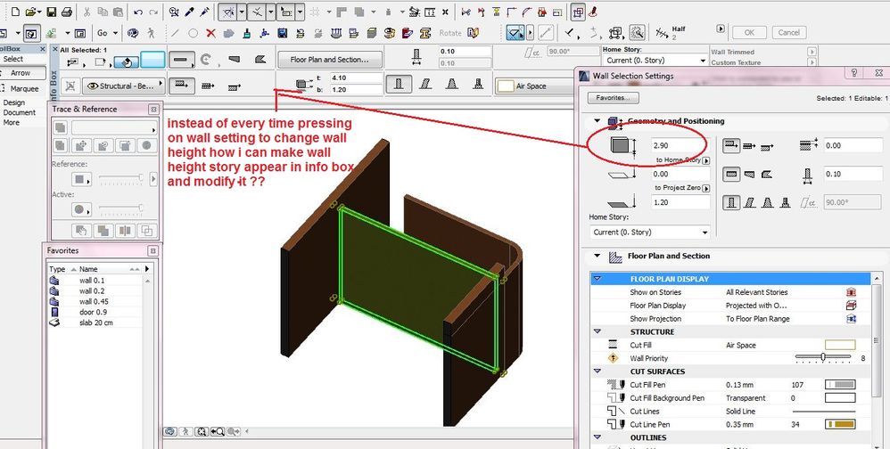

modify wall height directly from infobox with true height ??
-modify wall height directly in info box with showing height home story only-
Hello there i wonder if there is anyway to show wall height home story ex: from first to second floor not from 0 to second and
modify it directly in info box without i have to press wall setting please help me
Thanks in advance ,

I think the short, and only, answer is no.
Despite user wishes, the Info Box shows the top and base elevation (relative to project zero only!) and the wall settings dialog shows the wall height, and relative & absolute base heights, relative to project zero or reference levels.
Cheers,
Link.
The info box indicates the elevation of the base of the wall and the elevation of the top of the wall. A simple substraction tells you the absolute height of the wall.
Try this: select the wall to be changed, add or sustract the number of feet inches required and then write the dimension obtained in the "t" for the new rop elevation.
This works, however is easir to go into Walls Setting Dialog and make the change there.
