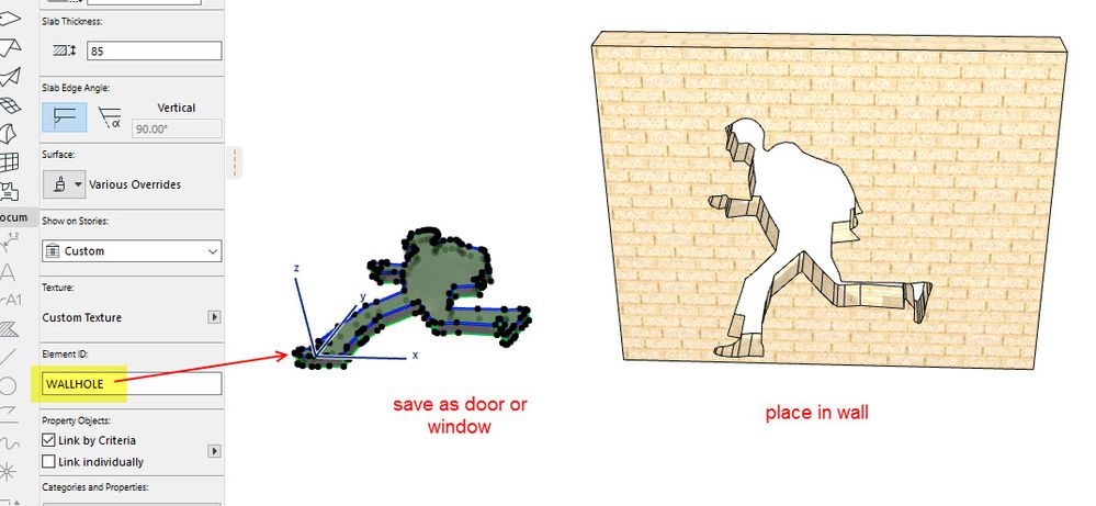

I want to do a custom arch wall opening;
1. can a morph be shaped to a specified radius and cut into the wall?
2. any good video out there to show the SEO
thanks

Llian
I have checked the renovation filter and it is NEW. I have done this before where I created a custom arch opening on a wall. I remember drawing the shape with the fill and then used the slab tool to create the shape into an object. I can't remember if I had to save it as an object. But I remember create a thicker slab than the wall and use the SEO to 'cut the opening' on the wall. I place the slab where the wall and adjusted the height of the slab on elevation....I am trying to find the video online that shows how to create a custom opening on the wall using SEO... still looking!

Try a renno filter that 'Shows All'
There is no need for saving as an object and the SEO.
Save as a door or window with ID = WALLHOLE.
Then place as door or window in your wall.
See image.
I am not sure about a video for SEO (check the YouTube channel in the HELP menu.
But if you create a slab for the SEO you will have to stand it up so will need to save as an object and then add ROTATE commands in the script.
Or convert to Morph and rotate it in 3D.
Then overlap the object/morph with the wall > SEO > subtract.

O My Goodness., Barry! Thank you so much. Is it that simple! I was just going into the Profile Manager and that was what I did before....but your method of saving this customize arch as a door opening just work on the wall! is this something new?

here is the image!

Nothing new.
It has been around for ages.
The WALLHOLE ID trick came in back at version 12 or 14 maybe.
Before that we had to edit the script manually.
Now if you need to you can add frames and glass.
Model exactly as you want them to be and set the correct building materials for them.
The bottom of your frame slab at zero 'z' height will be the front of the frame in the wall.
Everything above zero will be the depth of the frame.
Model below zero if you want something to stick out in front.
Just re-save as the same object if you need to amend anything.
If it was just a simple arch you could have used one of the standard arch shapes in the door tool... but at least you learned something new
