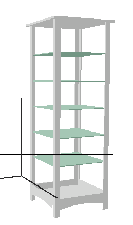

i can't have the plan filled.
7 REPLIES 7
here's 2nd pic showing the 3d model ....
and here's the object's part....i added the background fill ...i know i am not doing it right...
all i want to do is to have the 2d plan as a solid fill....

If you don't want the fill to be parametric, this can be quite easy.
If you saved your object from the 3D window (top view), then the 2D Symbol of the library part can be opened and you can just use the fill tool there to place a white fill. šŸ˜‰ (Open object editor, click on 2D symbol button - only 2D tools will be active in the tools palette, but you can use any of them to modify your plan symbol ... including the hotspot tool to add additional hotspots if they are needed.)
(Or, if you are saving the object from plan, then you can place the white fill in plan before saving.)

thanks karl....i'm not giving up....it's alot of investment and i'm gonna make it.
i have tried adding a solid fill with the fill tool before i saved it...but i am feeling that i am missing or just not putting the 'saving' steps in the right order.
i've created the objects and open 3d /plan view and saved the object.
but the solid fill is still not showing????
for sure, i can add solid fill as i place the object but that adding fill over the object should be done in the 3d object itself. i know it probably just take second to add but i just want to know how to have that solid fill as parametric...i am trying to understand what you said about solid fill as parametric but looks like i am not getting it...i guess i need visual step by step.
ok, i got it...i just added the fill from the object 2d symbol...oh my it is so simple and powerful.....wow!!!!!
