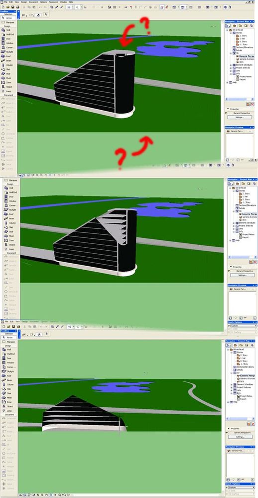

I was working in perspective view and I am not sure what I did but it seems like I broke it. haha
anyway i can either see a small upper portion of the house which is tipped on its side 90 degrees and if I try orbit or 3dfly it just goes white and the movements do not work.

I'm having same problem, must be some kind of bug, searched topics for last five months and didn't find anything related.
But I've got one unsympatic solution for u and thats to open a new template and copy/paste your work there.
First pic: you can c that it starts when camera get close to the building
Second and third pic: if camera turns just a litle bit, half of the building is gone
Its like some "cutting plane" that cuts the view but you cant turn it off.
Dwight
Nicola is on the money, here, sinice merging into a new project leaves the problem behind. We are calling it the Evil Chopping Block of Invisibility.
ECBI
