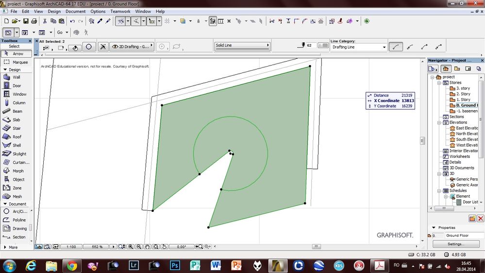

problems with stairmaker

I didn.t use polylines, just fill and circle.

The line of travel MUST be constructed with LINES (NOT polylines , arcs, circles...)!!

Well, I did exactly as you said and its not working...don.t know why. Probably I.ll end making it piece by piece...

One way to do is:
1. Make a rectangular form Spiral Stair with Olivier Dentan´s object "Escalier Carrezu OD.gsm"
2. Skew the stairs with Karl Ottenstein´s object "Skewer.gsm"
