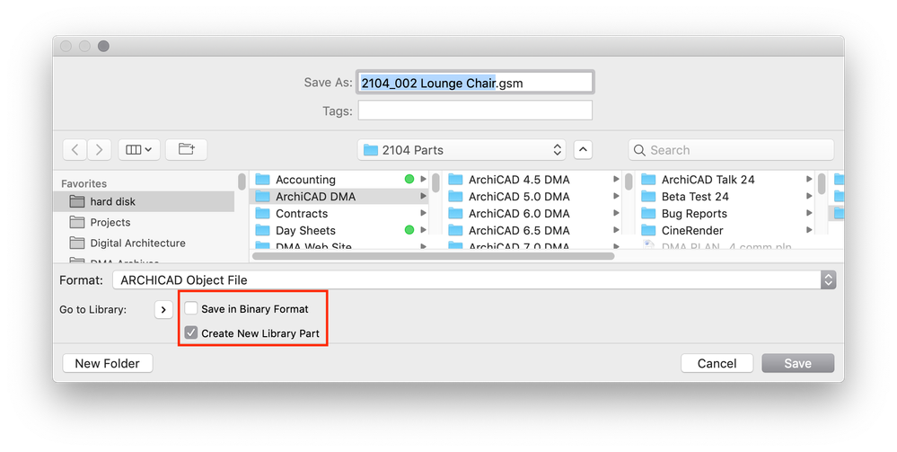

archigreen:
In the Save As dialog box for library parts, at the bottom left corner there should be two tick box options: Save in Binary Format, and Create New Library Part. Do not check the first, do check the second. (This is looking at AC21, assuming AC20 is the same.)
David
