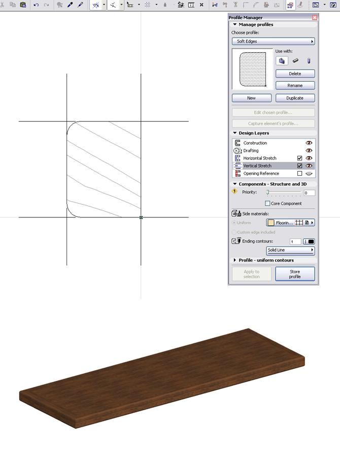

maybe this would help a bit.
i used the Profile mannager to create a profile with round edges and used it with the wall tool.
then i basically modelled the edge of the table with the profile i made and then just filled in the middle part with a slab. if you render it you would not notice its made out of two componets.
Hope this helps....
