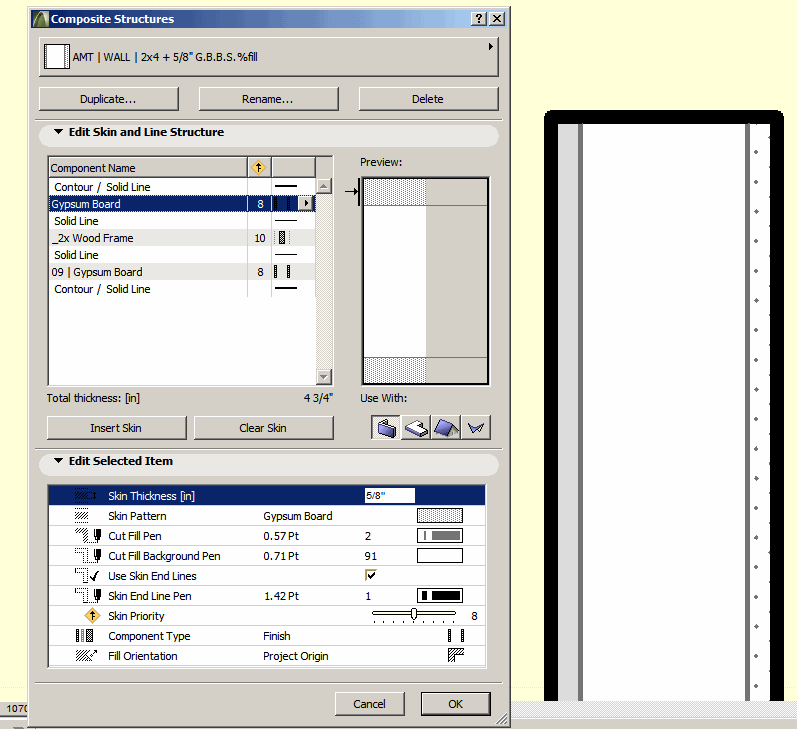

Here is a simple composite wall with gyp on both sides, but displays differently on apposing sides.
A clue to why that is?
As best as I can tell, settings are the same.
3d4draw

The fill pattern has an origin, and in one skin the distance from the origin allows the dots to display, in the other skin the fill is at a point between dots. See my image below. All 3 fills have the same pattern (gypsum) and the same origin, but one fill looks empty.

It's also going to depend on where your wall is situated. Move it a few millimetres and you might get a different outcome. Depending on the scale of your drawings it probably isn't an issue anyway, is it?

The spacing of the dots can be adjusted in the Fill Types dialog box. Or you might just change the Gypsum Board fill to a different fill with no dots.

I have begun using percent fills for these situations. They are uniform regardless of scale or position.
The fused ink process laser printers combined with the excellent resolution of PDF's makes fading an obsolete concern. Most commonly, I use gray values of 20% and 40%.

I set a gyp fill copy up like that and it works nicely.
However I guess I could have used one of the stock (or modified stock) %fills.
An interesting thing develops though.
After applying a modified gyp % fill in the composite it shows as expected, great.
Then for fun, when I changed the composite %gyp back to the stock gyp fill,
it continues to display the %gyp fill.
Of course tried it with different composites and did rebuilds, closed and reopened file and still still stays on %gyp fill even though composite says it has returned to stock gyp fill.
I'm I missing the obvious?

Just looking at your screen shot, there are 2 different fills assigned to the 2 gypsum board layers: "Gypsum Board" and "09 | Gypsum Board". Shouldn't these be assigned the same fill?

David wrote:
David
Now that's embarrassing
I forgot to look with my looking eyes.
Thank you
