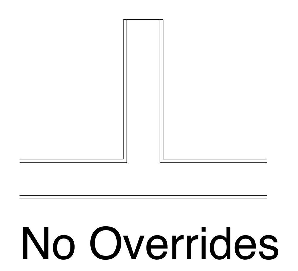

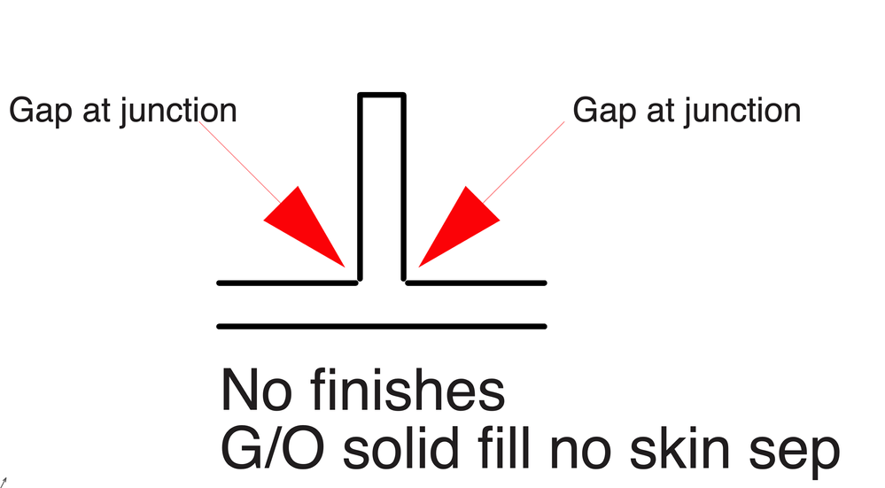

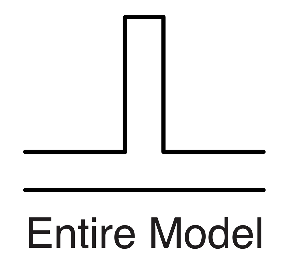

I'd like to show core only on my plans, and use a graphic override to hide the fills.  Small gaps are showing at each wall junction, where the finish has been hidden.  Pics attached.  This is not ok!
Entire Model no overrides.pngEntire Model with solid fills graphic override, no skin separators.pngNo finishes Graphic override - gaps!.png
