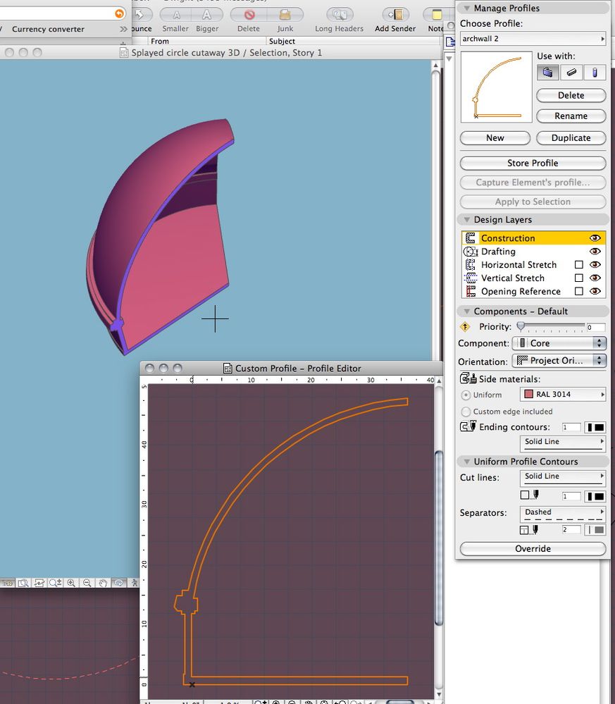

This fancy roof made with wall tool and complex profile
See:
complex profile
undefined
