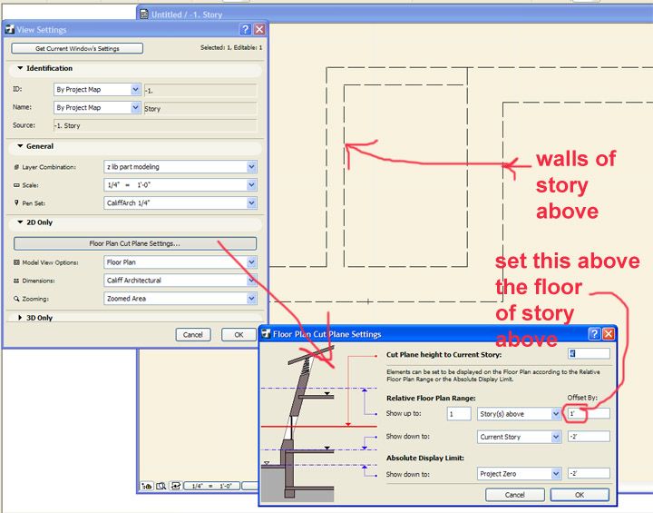

If your view cut plane settings is set to show higher than the floor of the story above, then the walls be shown dashed.
In the attached screen shot I arbitrarily picked 1', but an inch would have done as well.
HTH
Erika

Erika Epstein
Show on stories:All Relevant Stories
Floor Plan Display:Projected w/ Overhead
Outlines>Overhead Lines: select the dashed line of your heart's desire.
The other settings don't affect this ability to see the dashed lines of the walls above.
HTH
Erika
