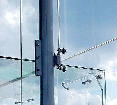

im trying to create a curtain wall with just glass pannels and spider fixing, but am having trouble in doing so.
i couldnt find any other posts with an explination on how to do it so i thought i would post.
thanks for your help
something like the attached image

i have managed to get just the glass but i can seem to set the spider junctions
