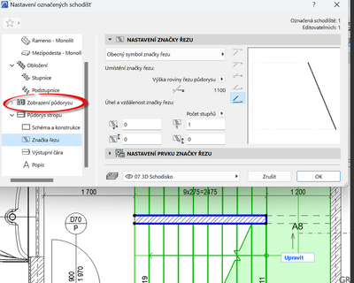

Hello,
I want to change symbol of section in my floor plan (you can see it in the picture). But even when I change stair section symbol in the stair settings nothing happens and the symbol stays the same (zigzag line). Do you have some advice what I am doing wrong? Thank you.
1 Solution
Bara3
Thank you, so much I have tried to find it for a long time.
Go to post
4 Replies 4
runxel
From the looks of it you're not actually editing the floorplan symbol, but the one for the RCP (reflected ceiling plan, which is determined by MVO).
Bara3
Thank you, yes, it it possible, please, where can I edit the floorplan symbol?
Bara3
