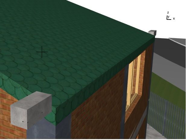

I noticed that, when two or more elements are superimposed, one of them partly not visible. In the picture I have a beam that is superimposed with a wall that had been trimmed under the roof. The beam is partly not visible.
Does anybody have a solution to this? Thank you.

Make your beam priority higher than that of the wall. Even though the wall is trimmed to the roof, the beam thinks it is still there.

Thank you. it worked.
