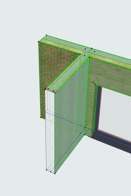

I'm having trouble keeping proper connection between 3 walls with differing finishes. The connection pictured on the left should not behave like this because of priority of building materials. Junction order is equal, changing it makes it only get bugged in different way. The junction on the right is what I'm aiming at - but it's only 2 walls.
Also - wall heights are the same and no connections above or beneath.

The problem is the junction is working properly in 3D, just 2D representation gets buggy. I don't understand why. I'd rather avoid modifying reference lines since im trying to apply walls with different composites to make conceptualizing easier - using different reference line modes is probably going to make it unnecessarily complicated at this point. I just don't get why styrofoam covers masonry, since it's building material priority is lower

By your 3D view I can see your wall reference lines seems to be good.
Did you try to modify display order of the shear wall ?

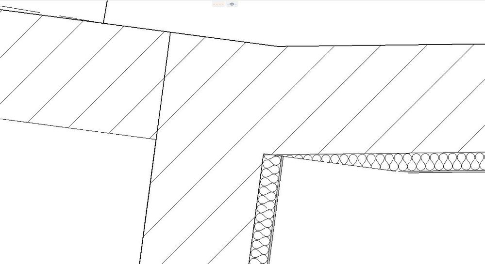

Display order doesn't seem to change anything - connection exists but is weird - as in attachment
 This occurs with all triple wall connections in this project - 2 wall connection works perfectly fine.

Eduardo Rolon
There is a trick were you create a custom profile column and place it in that corner to make sure everything looks correct.
https://community.graphisoft.com/t5/Design-forum/Clean-up-junctions-in-composite-walls/m-p/182911#M9...

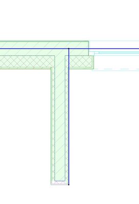

I am having exactly tha same problem. 3 wall junction and the walls a behaving very strangley. I really dont know what to do. I have checked materials strength, wall priority, reference line.
Why is the adjacent wall affecting the interior skin of the composite wall that it is joined to like this???.
Unfortunately it is happening on several wall junctions, in both 2d and 3d.

and these junctions:
