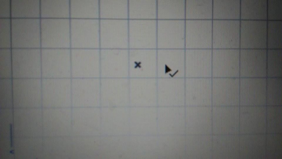

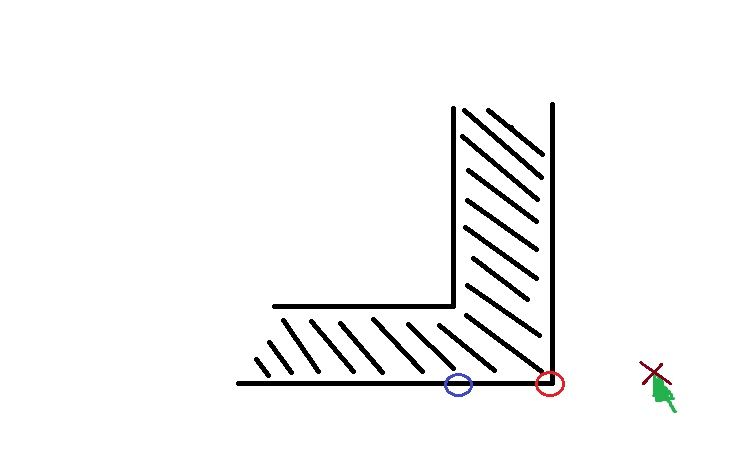

Hello, I have a problem with snapping - click on the mouse and place a mark elsewhere (eg. If I want the bottom right corner of the wall to place the line or anything else)
Attached is the picture sketched for better orientation and picture, which is directly visible problem.
When I click the mouse in the red circle (and I want eg. To make wall / line ..) so to me it marks the point of the piece next to my chosen (as there is the blue circle)
Because if I wanted to mark the lower right corner so I have to click a piece right off the wall, see. green mouse cursor ..
Do you know anything about how to solve this problem? I happily accept any advice because of that problem goes my work in ArchiCAD 19 very slowly. This problem also occurred to me in ArchiCAD 16

If I understand you correctly, check to see if you have "Grid Snap" under View accidentally checked. There used to be some short cuts that all too easily activated this setting.

There was a problem with snap when 19 was first released. An update fixed it. Make sure you have the latest version of 19.

Here is the screenshot. Note the default shortcut shown is for a mac. It may be different on a pc.
