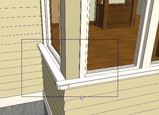

something new every day, you know...today, for no reason I can discern, my windows have these wacky-WACKY!-projections in elevation and in 3D. They are not visible in plan. The corner windows are simply windows, not a corner window. But they are set up to gang on both sides, anyway, so I can't figure out what is going on...thank you...

James wrote:James, you might check that the two walls, full and wainscot, don't have their reference lines on top of one another. [not quite sure how to word that].
This particular home has a stucco wainscot below the brick sill which I have added using a thin wall. This seems to prevent the windows from joining at all. If I turn the wainscot layer off and join the windows, it works, then I can turn the layer on again and it stays connected. Very frustrating.
2005-12-02 11:34 PM
Erika wrote:Erika, You are right, they were on top of one another (because that's the easiest way to snap the wall to the other wall). Changing it definitely solved all of the problems with the corner windows. Thanks!James wrote:James, you might check that the two walls, full and wainscot, don't have their reference lines on top of one another. [not quite sure how to word that].
I've found this usually resolves the problem.
