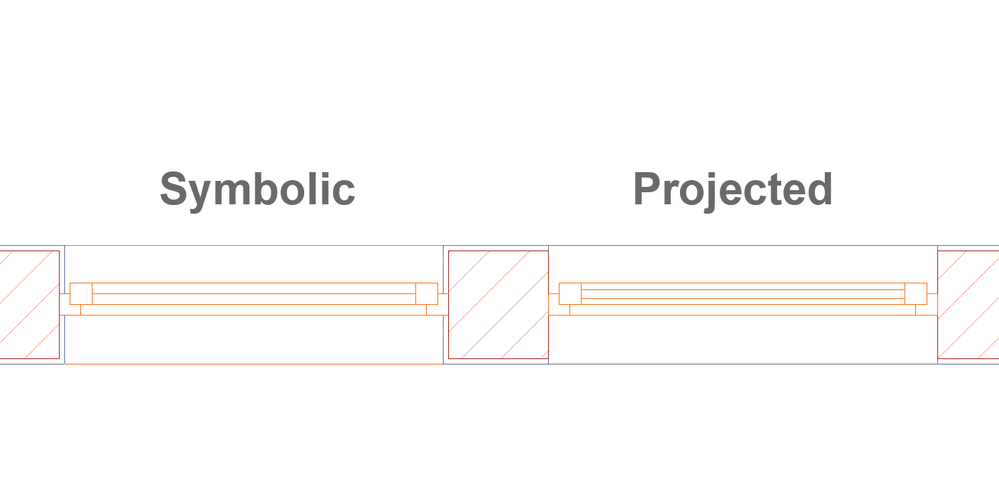

Wall closure does not work when I turn the symbolic floorplan view in windows to projected view. Screenshots of the view are attached.
Also, how can I make the glass get represented by single line instead of two in floorplan. Pls help

I have the same problem. Whenever i change from symbolic to projected the wall closure disappears. Do you have to do any special settings, because i get this problem using the archicad's template with walls that are already defined by graphisoft?
I've tried to find a solution to this problem for a long time, but without luck.
Yes, this is unfortunately a limitation.
The wall closure is a 2D symbolic representation, but it is not generated in 3D (possibly because it may make the geometry of windows rather heavy), and because it is not generated in 3D it is not generated when the "Projected" option is selected for Floor Plan Display.
