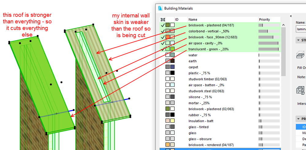

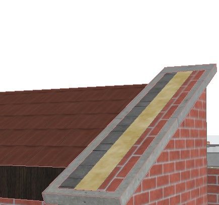

when trimming a wall to a basic composite roof it looks like the trimming surface is to the top of the roof rather than underneath so the structure of the wall is visible. How can i change this to hide the wall?
1 Solution
If your roof is not a composite, set it to use a building material that is stronger than any used in the wall.
If it is a composite, edit the composite so the building materials used are stronger or choose a different composite that already users stronger building materials.
Basic principle is stronger material cut weaker ones.

Hi @EGM66,
It’s a material priority issue so try to use SEO it will work for you.
AC 29 INT 4006/WIN 11
Or make the building materials in the roof stronger than those in the wall.
EGM66
Thanks, that worked for me
EGM66
hi Barry how would i achieve that?
Lingwisyer
Guru
Options => Element Attributes => Building Materials => [BM in question] => Intersection Priority
*I think this path changed in the recent versions of AC.
**The may cause undesirable changes to other intersections
Ling.
Win11 | i9 10850K | 64GB | RX6600 Win11 | i9 11900K | 32GB | GTX2080TI
