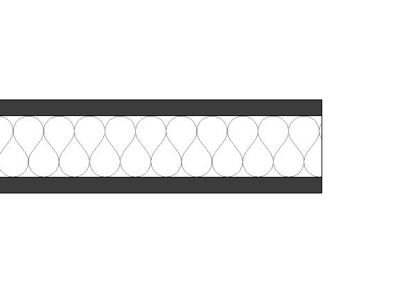

i have a composite with plasterbord in outside and  inside and an insulation between. whats the best practice to wrap the plasterboard around the open side?Screenshot_4.jpg

There is the Wall End Tool. It can be set to wrap the finish. Do note though that it fits entirely within the reference length of the wall. So it is essentially fixed to Wall Inside / Outside with no concept of Core Inside / Outside.

As @Ling said, Wall End Tool is quite useful. Be wary, though, that some use cases can have unwanted results, because the Returned End (in my humble opinion, the most important type of the tool) is bugged - it shows lines on the contact of the same type of surfaces / materials.
